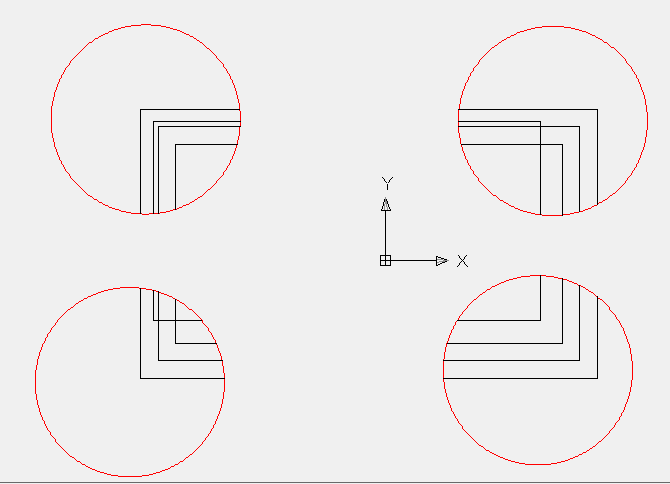

Hi community, What I want to do is to trim some polylines that are saved on memory as VLA-OBJECTS, deleting everything of them outside of some circles, that are also saved as VLA-OBJECTS on memory, and I want to do it automatically (without selecting anything because they are already stored on memory even the center of each circle). On the images you can figure what I am saying out in a better way. Can you suggest me any lisp or autolisp or Vlisp routine for this task please?. I am providing a copy of lisp program on attached files if it is useful for you. Many thanks in advance.

Please upload a sample DWG , in 2007 or less version.

Some like it?

Yes something like it devitg can you help me with the code please

But first, and please, upload YOUR´s sample DWG , the same DWG from where you pick the screenshoot, you had post at your first question.

Hi sorry for being late at uploading my file. Here it is

Sorry Here it is with the circles and blue lines.

Hi J.Portela , please see the attached file.
