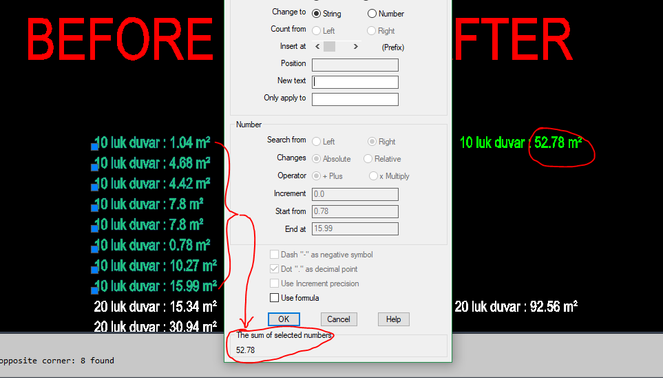

Hello
How can I get the sum of the values I gave in the sample drawing?
I colored the objects. to be descriptive. But I will make the selection manually...
Thanks in advance

You can also try ALTEXT.
The number sum is shown at the bottom of the dialogue box.
