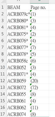

CAN anyone EXTRACT above USING LISP TO csv. file? There are batch of data are need to be extract.
Sample:
Beam , Page
ACRB079c*, (4)
Thank you very much!

@skchui6159  hi,
check this ACRB2CSV command.
Any good reason why your texts object are set with backwards = yes and upside down = yes?  what does this serve???
Note:
the program match pairs of texts ACRBnnn with (n) by distance. make sure the right (n) is most close to ACRBnnn.
on my excel a text field starting with '(' means starting some function so i guess you will have to change them to [] or something else
enjoy
Moshe

Message 5 of 13
skchui6159
@Moshe-A Thank you very much for your help!🙏 That can solve lot of problem for my orginal key plan checking!. 😁
Reply with "Any good reason why your texts object are set with backwards = yes and upside down = yes?  what does this serve???". Because the texts objects are created by different person. May be they use mirror function. I dont know.😰

1. run find_beam_pairs. it will find and color each pair with 1-incremented index color starting 1 (red).
2. check if all pairs complete. beam ACRB072* has 2 pages near to it. i just moved its (4) page closer to insertion point to exclude missing pair.
3. run find_beam_pairs again to check every pair is correct.
4. run change_beam_pages to change each beam page according to Change to Page no. column in the csv file.
you've got it.

skchui6159
@komondormrex Thank you very much, it is exactly what I want. You got it complete 100%! thank!
@Sea-Haven Thank you for your sharing to write to csv. (Re: Why I am not write direct to excel? Because I find that there may not run easily in different version in autoCAD.😅 Write a block, it is good idea!
Cheer!
