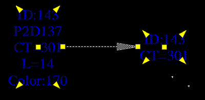

Hi everyone
How can remove from all mtext, for example first line or second line or third line.... N line?

Hi dear komondormrex
Is it possible to remove blank lines from the result?
Message 8 of 13
neam
I want the first line and the third line to be deleted so that only the second line remains.
Message 9 of 13
neam
Of course, this is an example.
In general, the mtext may have more lines and we want to delete some lines and keep the rest of the lines.
Message 10 of 13
komondormrex
sure. check update.
