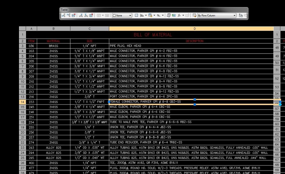

Can anyone confirm there's no way to globally remove character formatting from tables?  I've done quite a bit of searching and found little on the topic.  Some search results mentioned the StripMtext LISP but that didn't work (I'm using AutoCAD 2017).
I found out a bill of material drawing I created had a different font selected which overrides the text style.  I never noticed because it displayed as simplex on my machine which is my default alternate font.  Anyway, it took quite awhile to manually remove the character formatting and I figured there must be a easier way.
Thanks!

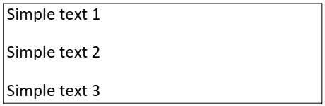

This script works almost perfect. Unfortunately it doesn't remove prefix from table text which looks like this:
{\fCalibri|b0|i0;
What could I change in this code to remove it?
I have in my table texts looks like below:
{\fCalibri|b0|i0;TEXT line 1
TEXT line 2
TEXT line 3
I need to look this like below:
TEXT line 1
TEXT line 2
TEXT line 3
Message 10 of 21

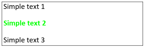

If there is no formatting inside text has value:
Entity value=
(1 . "{\\fCalibri|b0|i0;Simple text 1\n\nSimple text 2\n\nSimple text 3")
Text value=
If there is some formatting inside text has value:
Entity value=
(1 . "{\\fCalibri|b0|i0|c1|p0;Simple text 1\n\\fCalibri|b1|i0|c1|p0;\\C3;\nSimple text 2\\fCalibri|b0|i0|c1|p0;\\C0;\n\nSimple text 3}")
Text value=
In both situations I wish to get as result only texts and new line chars:
Entity value=
(1 . "Simple text 1\n\nSimple text 2\n\nSimple text 3")
Text value=
Attached new DWG file with changed texts in tables.
