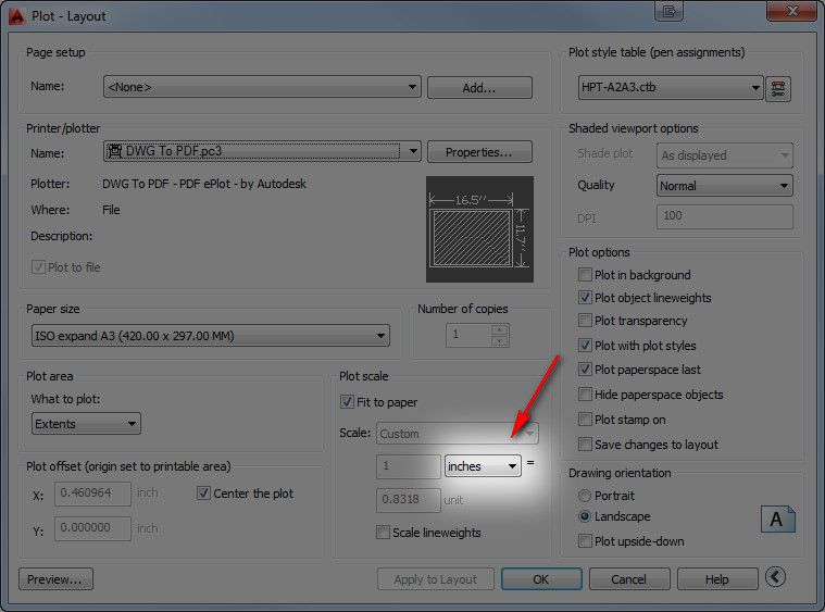

Dude, I am using your first code. Although it does the job but I noticed some weird behaviour.
Here is how my layout looks like before running your code:
Immediately after running your code, here is what I get:
Any idea why the plot unit is changed to "INCH"?
Message 5 of 13
hencoop
The Page Setup should have a name.  The program sets the page setup by name.  If after it has been set the name is <None> then there is a problem with the source of the page setup being used or it is coming from a template file that was last saved from a different version of AutoCAD.
The change of units is part of this problem.
In our office one user is on Civil 3D 2013. Its page setups will produce similar results in my Civil 3D 2014.  Use a template file that you have created or revised.  Set your desired page setup settings and then use the Add... button to update the definitions to make them work in your sessions.
Also, if you are plotting a layout the plot area is best if set to "Layout" which will always correspond to the paper size of your page setup.  Plotting Layout is highly recommended for its easy association with a Sheet Set to access its great plotting and publishing abilities.

Message 6 of 13
joselggalan
try this
(defun C:RefreshAllLayout_1 (/ oLayout AcDoc)
 (setq AcDoc (vla-get-ActiveDocument (vlax-get-acad-object)))
 (vlax-for oLayout (vla-get-layouts AcDoc)
  (cond
   ((= (vla-get-ModelType oLayout) :vlax-true))
   (T
    (vla-RefreshPlotDeviceInfo oLayout)
    (vla-put-PaperUnits oLayout acMillimeters)
   );c.cond
  );c.vlax-for
 (princ)
);c.defun
