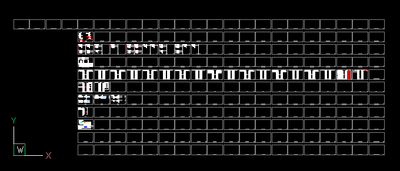

In all transparency, I used Chatgpt to write most of this code. I've tried variation of this base of my search results and I am stuck.
I have multiple sheets that are identical and the viewport need to be panned over a specific amount to maintain consistency. While inside the viewport I use the -Pan command the for left & right is 1200inchs (or units) and up & down will be 1440 inchs (or units). I would like help where the command prompt asks which direction and the view inside the view port pans in the specific distance.
If anyone is up to adding the process of selecting a viewport, making the viewport active and unlocking if lock, then using the  -pan command. 🙂

Definitely don't rely on Chatgpt because the codes written are all wrong.
Assuming your vport is not locked, try these modifications:

I would not go down pan method rather use either a block or a rectang and then make the layouts to suit, this is follow a pline making layouts, at correct scale and sheet size. A grid version would be easy. You can move/ rotate or delete the rectangs then make layouts.
Just did 28 layouts from this if nothing inside then skip.

Other things ChatGPT doesn't understand yet:
How the (initget)/(getkword) system works.  One of its features is that if you type in the right character(s) in response to (getkword), in any case or case combination, it returns the spelling and case combination as in the (initget) argument.  So you can type in U or u or Up or up or UP or uP, and in all cases what will be returned will be "Up."  So the (strcase) operations are unnecessary.
That inside an AutoLisp (command) function, the hyphen prefix is not needed on command names.
That a simple (=) function works with text strings as well as numbers -- (equal) will do it, but has other capabilities not needed here [e.g. a fuzz factor in numerical comparisons].
That the PAN command can be simplified, by giving it a displacement and just Enter to use that as one, rather than as a point.
So, a further simplified version:
