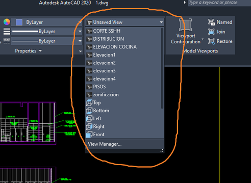

hello everyone
I have a problem that suddenly can be solved with a lisp
https://forums.autodesk.com/t5/visual-lisp-autolisp-and-general/need-lisp-to-add-new-layers-to-exist...
I have an Architecture base and created saved views,
but as I add layers (because that is usually my work routine)
When I change views, all the layers created after the views were created are frozen.
I think even LAYER STATES have the same characteristic.
I would like to see if it is possible that there is a lisp that updates all the saved views (with all the current layers)

jorgearone_inssitu
Ok, I have saved views
I have a problem that suddenly can be solved with a lisp.
When I create the views, I keep creating layers (that's my workflow) and work with them (they are not turned off or frozen), but when I change views, the layers disappear, as you can see, the layers created after creating the views views are frozen (when changing views)
ВeekeeCZ
So why don't you save the views WITHOUT layer snapshot
jorgearone_inssitu
Thank you very much, I did not know that option.
Yes indeed that is the solution. Thank you very much again.
