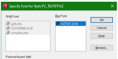

Note: Make sure all the fonts are found so the following alert window does NOT appear interrupting the opening of each dwg
