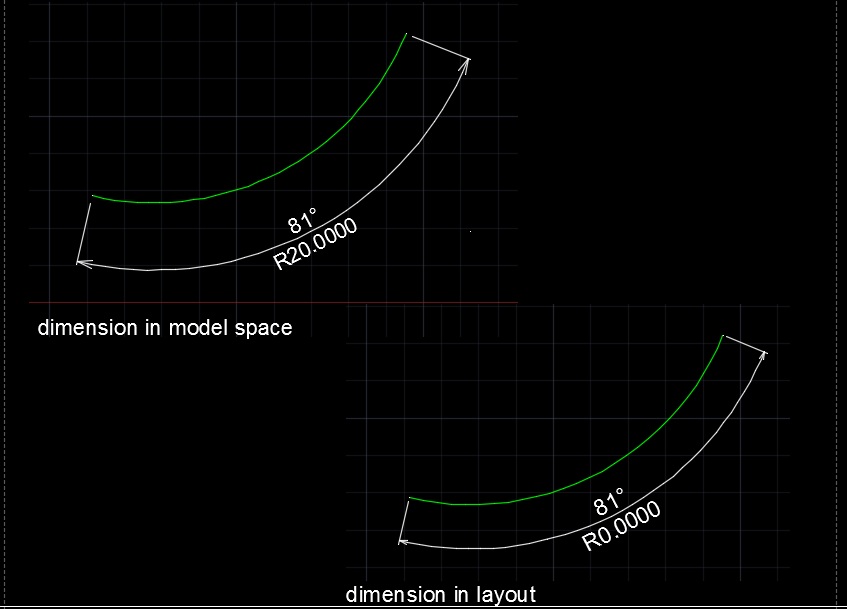

Good day!
I am a working as a landscape detailer, and in our drawings we encounter a lot of arcs and curves which requires dimension angle and a dimension radius below at the same time in our setting out plan, i do not know lisp programming. Lisp masters please help me come up with a lisp with this routine. see my attached image for the dimension that i need and i hope it will work both in model space and layout..
Thank you very much,
Ron

marko_ribar
Firstly setup Dimension Style - especially angular properties as type : decimal degrees with precision, degree/minutes/seconds with precision and instead of using DAN command, use DANR...

Message 3 of 24
marko_ribar
Updated version, should successful work in all UCS / Views in 3D space...

Message 4 of 24
Sir:
i really appreciate your response, sir as i try to use the lisp, there is a slight problem occurs, as i try to move the dimension to position it the dimension radius below disappears, and also the drawing temporarily adjust its ucs when dimensioning, hope we can do a little adjustment for this lisp,
thank so much again,
Ron

Message 6 of 24
marko_ribar
This is the best I could do, but still it depends on orientation of arced entity/sgement in 3D space...

    (if xp (command "_.UCS" "_P"))
    (command "_.REGEN")
    (vla-endundomark (vla-get-activedocument (vlax-get-acad-object)))
    (if msg (prompt msg))
    (princ)

  (vla-startundomark (vla-get-activedocument (vlax-get-acad-object)))
  (setq el (entlast))
  (prompt "\nPick arced entity to dimension angular with radius value")
  (setq ss (ssget "_+.:E:S" '((0 . "ARC,CIRCLE,*POLYLINE"))))
  (while (null ss)
    (prompt "\nMissed, empty sel.set... Try picking arced entity again (ARC,CIRCLE,*POLYLINE)...")
  (setq e (ssname ss 0))
  (setq p (cadr (cadddr (car (ssnamex ss)))))
  (setq pe (vlax-curve-getclosestpointtoprojection e p '(0.0 0.0 1.0)))
  (setq u1 (list (trans '(1.0 0.0 0.0) 1 0 t) (trans '(0.0 1.0 0.0) 1 0 t) (trans '(0.0 0.0 1.0) 1 0 t)))
  (if (not (or (equal '(210 0.0 0.0 1.0) (assoc 210 (entget e)) 1e-6) (equal '(210 0.0 0.0 -1.0) (assoc 210 (entget e)) 1e-6)))
    (progn
      (command "_.UCS" "_E" (trans pe 0 1))
      (setq u2 (list (trans '(1.0 0.0 0.0) 1 0 t) (trans '(0.0 1.0 0.0) 1 0 t) (trans '(0.0 0.0 1.0) 1 0 t)))
      (normucs)
      (setq u3 (list (trans '(1.0 0.0 0.0) 1 0 t) (trans '(0.0 1.0 0.0) 1 0 t) (trans '(0.0 0.0 1.0) 1 0 t)))
      (cond
        ( (and (equal u1 u2 1e-6) (equal u2 u3 1e-6))
          (setq x 0)
        ( (or (and (not (equal u1 u2 1e-6)) (equal u2 u3 1e-6)) (and (equal u1 u2 1e-6) (not (equal u2 u3 1e-6))))
          (setq x 1)
        ( (and (not (equal u1 u2 1e-6)) (not (equal u2 u3 1e-6)))
          (setq x 2)
  (command "_.DIMANGULAR" (trans pe 0 1))
  (while (> (getvar 'cmdactive) 0) (command "\\"))
  (setq d (entlast))
  (if (not (equal d el))
    (progn
      (if (or (eq (cdr (assoc 0 (entget e))) "ARC") (eq (cdr (assoc 0 (entget e))) "CIRCLE"))
        (setq r (cdr (assoc 40 (entget e))))
        (if (eq (cdr (assoc 0 (entget e))) "POLYLINE")
          (progn
            (command "_.CONVERTPOLY" "_L" e "")
            (setq r (_plsegrad (vlax-ename->vla-object e) pe))
            (command "_.CONVERTPOLY" "_H" e "")
      (setq dn (cdr (assoc 2 (entget d))))
      (setq db (tblobjname "BLOCK" dn))
      (setq dt db)
      (while (/= (cdr (assoc 0 (entget (setq dt (entnext dt))))) "MTEXT"))
      (setq txt (cdr (assoc 1 (entget dt))))
      (setq ang (substr txt (+ 2 (vl-string-search ";" txt))))
      (setq txtn (strcat "\\A1;\\S" ang "^R" (rtos r 2 2) ";"))
      (entmod (subst (cons 1 txtn) (assoc 1 (entget dt)) (entget dt)))
  (*error* nil)
 HTH, M.R.

One more revision... Sorry for this, but I am constantly testing it and constantly finding lacks... Now should be fine for now...
(defun c:danr ( / *error* _plsegrad normucs el ss e p pe d dn db dt r txt txtn u1 u2 u3 x xp )
  (vl-load-com)
  (defun *error* ( msg )
    (if x (repeat x (command "_.UCS" "_P")))
    (command "_.REGEN")
  (setq el (entlast))
  (while (null ss)
    (progn
      (normucs)
      (cond
          (setq x 0)
          (setq x 1)
          (setq x 2)
    (progn
      (command "_.UCS" "_W")
      (setq x 1)
  (setq d (entlast))
    (progn
          (progn
      (setq dt db)
  (*error* nil)
 M.R.
Marko Ribar, d.i.a. (graduated engineer of architecture)

trevor.bird.au
Hi Ron,
This code will allow you to add the arc radius to existing angular dimensions in modelspace and paperspace.
If you want to include the arc length then remove the semi-colon from the appropriate line.
The arc length is suffixed to the default dimension text (i.e. "<>") and will not be reset if you reposition the dimension line or dimension text.
If the geometry is changed for the dimension then you will have to rerun the program on the changed dimensions to update the arc radius and arc length values.
Please note that the dimension text value will always be reset to the default value of "<>".
If you need to add the arc radius to a user input dimension text value then please feel free to let me know and I will add the option.
I hope this helps you.
Regards,
Trevor

hi sir,  i found your lisp very usefull, thank you so much. Anyway sir, i found one lisp which is also functions the same. the only problem with this lisp is that when i try use the routine in layout it gives incorrect radius dimension, see my attached image, we are likely dimensioning our drawing in layout so thats why it would be a great help if you can correct this lisp that i can also use this in layout.. hope u can do your magic with this lisp.
Thanking you so much,
Ron

Message 14 of 24
and also give the dimension radius which is not round off, please also adjust the round off seetings to the second demical point as to 00.05,
thank you again,
Ron

trevor.bird.au
Hi Ron,
You're welcome and thank you for the kudo.
The angle value of Angular dimensions do not require a scale factor as opposed to linear dimensions which return a distance which has to be scaled to suit the Zoom XP factor of the Paperspace viewport.
Angles are not scaled.
This feature of Angular dimensions means that any dimension style with any scale factor can be used to place Angular dimensions in a Paperspace layout albeit not good practice to do so.
The code you provided can be modified to return the correctly scaled Radius and Arc Length but it is dependent on having the correct dimension style current with DIMSCALE, DIMLFAC etc. configured correctly and the dimension text value changed after placing the dimension.
At the moment the code is providing the dimension text value with the suffixed Radius value during placement of the Angular dimension.
The Radius value is not scaled correctly as it is the length of the line drawn in Paperspace.
As per my code, the Arc length and Radius can be calculated from the Angular dimension setout points after it is placed, but not during placement.
If the current dimension style is configured correctly, then it can be queried to determine the scaling factor to apply to the Radius and Arc Length values calculated from the setout points.
If the selected dimension is NOT associative, my code is still dependent on the dimension style of the selected Angular dimension to be configured with the correct values for DIMSCALE, DIMLFAC etc..
Associative dimensions are actually easier to query for the correct scale factor because a link to the Paperspace viewport is saved with the dimension and the scale factor calculated from the Paperspace viewport Zoom XP factor and not the DIMSCALE or DIMLFAC values of the dimension style.
At the moment, my code does not take into account dimension Overrides i.e. DIMLFAC or DIMSCALE which can be applied to the dimension.
The dimension style used to place dimensions in a Paperspace layout will have to be configured to be one of the following:
  1. Associative which requires:
    AutoCAD system variable DIMASSOC to be set to 2.
    DIMSCALE of the dimension style to be set to 0.
    DIMLFAC of the dimension style set to 1.
    Placed dimension will use the Zoom XP factor of the Paperspace viewport in which the dimension points were selected.
  2. Not Associative which requires:
    AutoCAD system variable DIMASSOC to be set to 1.
    DIMSCALE of the dimension style to be set to 1.
    DIMLFAC set to suit the Zoom XP factor of the Paperspace viewport.
If there are multiple Paperspace viewports using different Zoom XP factors then a dimension style for each will be required.
I hope my explanation makes sense.
