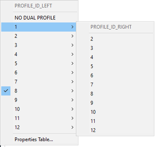

What do you do with these data? how does that relate to the Visibility and Attributes ?
PROFILE_ID_RIGHT doesnt even have the value of 1
Message 8 of 13
reginald-grimes
So the goal is, if I decide to import the "profile_id_left" / "profile_id_right" values from the csv, it would then match the visibility parameters/states that have the equivalent name/number.  Which I would like the lisp programming to recognize these attribute values and match the corresponding visibility parameter/state name.  See below:
  • attribute value "profile_id_left" = visibility parameter/state "profile_id_left" name
  • attribute value "profile_id_right" = visibility parameter/state "profile_id_right" name
I would like for the csv to export all block attribute fields with headers.  I would also like the csv to contain the block handle.
By the way, the value of 1 missing from "PROFILE_ID_RIGHT" selection menu is just an oversight on my part.  I can add that later.  Thank you kindly for your assistance and I hope I've not confused you with the additional information I've provided in this post.
