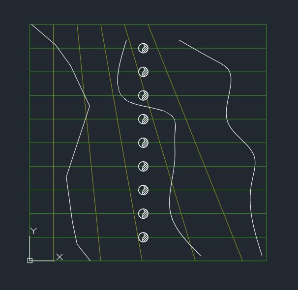

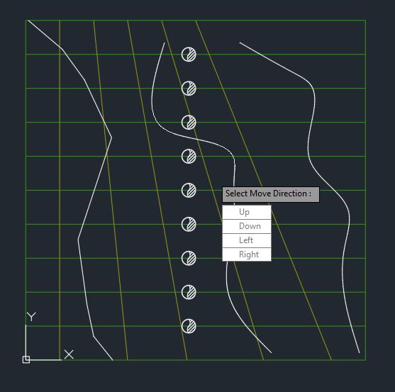

I am looking for a LISP program that will allow me to window/intersection select multiple blocks and move them horizontally to the nearest intersection with a line/p-line/spline in a selected direction. I also need the program to automatically detect the nearest curve in the selected direction. I do not want to have to select a curve manually.
The command would have the following prompts:
1. Select blocks
> I select the blocks with a window or intersect then hit the space bar
2. Prompt direction
> I select a direction
> Blocks are moved to the nearest line/polyline/spline in the selected direction
I have included screenshots showing the desired steps.

I was wondering if you could add a conditional so the blocks ignore curves on locked layers. I would also like to handle an edge case: if a block is already located on a line/curve then blocks move to the next curve. I have attached photos of the edge case. Thank you again.
