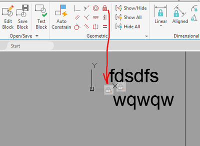

you can force the text to mirror regardless of mirrtext variable if you fix it inside the block with fix geometric constraint.
