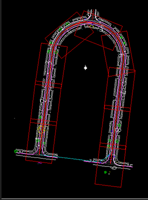

Hi Kent in our civil plans we would use multiple UCS as we walk along a road so road is shown horizontal in a layout, sometimes we would not reset the world UCS in Model. It would  be like last view direction used. So may need the Current UCS if setting view. Not sure though if it would be twisted, but zoom C should still work. Have a look at image, red rectangs are layout views.
