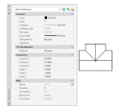

I'm working on yet another lisp (y'all got me hooked, I swear) that's attempting to take all the blocks in a drawing and make a table with them. I started with the two lisps linked below - the first one was almost exactly what I wanted for a table, but didn't handle the dynamic blocks well. The second counted dynamic blocks, but didn't have a way to make a good table. I tried to combine them and kinda wrecked it. Either way, neither of them allowed for counting based on the SIZE attribute, which is kind of important.
Basically, I have a ton of different 2D valves in a drawing. The valves are dynamic so I can switch between types (ball, globe, gate, etc) in-place without messing with the size. The size is an attribute (2", 3", 1/2", etc) for the block. There are a few stand-alone valves that I also need to count. I want the table to be "Block Name" "Block Type" (that's the visibility state) "Block Size" (attribute). That way I can quickly tally up what I've got in the drawing  and figure out how many 2" ball valves I need, 3" butterfly valves, etc.
Thoughts?

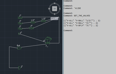

komondormrex
should have got, see below, but.... some blocks missing visibility property...skipped. need to tune the code

komondormrex
check updated code below and what it outputs. that list has to finally go to the autocad table.

(defun c:get_the_valves (/ insert_sset valve_list size_attribute vis_property)
  (if (setq insert_sset (ssget "_x" '((0 . "insert") (66 . 1))))  ;selects all attibuted inserts
    (progn
	(setq valve_list (parse_list
			   (vl-remove nil
		       		(mapcar '(lambda (insert) (if (and (vl-some '(lambda (attribute) (= "SIZE" (vla-get-tagstring (setq size_attribute attribute))))
			                  			    	     (vlax-invoke insert 'getattributes)
								   ;checks if there is "SIZE" tagged attribute in insert
				                                   (if (vl-some '(lambda (dyn_property) (= "Visibility1" (vla-get-propertyname (setq vis_property dyn_property))))
								    	     	 (vlax-invoke insert 'getdynamicblockproperties)
								       (setq vis_property_value (vlax-get vis_property 'value))
								       (setq vis_property_value "")
								   ;checks if there is "Visibility1" dynamic property in insert
						      	      (list (vla-get-effectivename insert) vis_property_value (vla-get-textstring size_attribute))
			  	     	 (mapcar 'vlax-ename->vla-object (vl-remove-if 'listp (mapcar 'cadr (ssnamex insert_sset))))
      	(foreach valve valve_list (princ "\n") (princ valve))
  (princ)

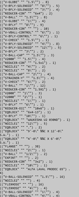

This may be because I'm mashing two different sections together but I'm clearly screwing something up. The lisp still works, but I can get a selection or a table.

(defun c:LISTBLOCKS (/ insert_sset valve_list size_attribute vis_property)
(prompt "\nSelect Area: ")
    (progn
			   (vl-remove nil
      	(foreach valve valve_list (print valve))
  (princ)
(defun c:add_valves_table (/ valves_list)
	(if (setq valves_list (get_the_valves))
		(add_table_from_list valves_list '("Block Name" "Block Type" "Size" "Count"))
	(princ)
Message 33 of 59

That works PHENOMENALLY on my 2D drawing! Can't get it to pick up the 3D blocks for some reason. I thought they'd be the same but there must be a different property that I'm missing. I'll see if there's a tweak I can use, thank you so much!

My apologies, I thought it would be a simple parameter substitution. Here's a sample file.
Message 37 of 59
komondormrex
well, these have no attribute,
while
you are not as dangerous as ought to be)
Message 38 of 59
wsonnek
I missed that. I thought it was a 2D vs 3D problem. I'll look at it again, but I'm guessing I can't just remove that line without blowing the code up?
Message 39 of 59
komondormrex
you cannot!
