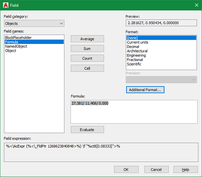

Hey all,
I'm attempting to build a label for coordinate layout, and I would like my labels expressed in feet (currently inches, desired conversion factor: .08333)
the problem is my conversion factor window on the additional format dialog box is greyed-out and not editable.
I would also like to edit the number separators for thousands, but I can live with just fixing the conversion factor...
any insight on what's wrong, or potential workarounds would be greatly appreciated.
179 Views
1 Reply
Reply (1)
paullimapa
First under Field names select Formula
In the Formula window right mouse click and select Insert Field
Now under Field names select Object and complete the process as you've done originally then click  the OK button
Back in the original Field window click the Evaluate button
Now the Additional Format button appears for you to click on:
Enter your Conversion factor and click the OK button:
Now the Preview will show the converted value from inch to feet:
