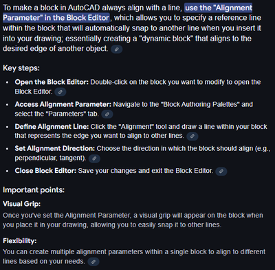

@yu85.info Are you aware you can create (and recreate your) blocks that do "... properly rotated along the line’s angle..." all the time?
