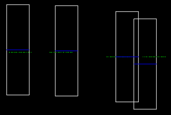

I think [@hythamthelove correct me if I'm wrong] the sample drawing has "before" on top and "after" below.  If that's right, what you describe would, I think, have this result [dashed green are the original Line positions]:
