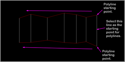

I'm looking for the same solution as you are but need polylines on both ends of the lines. Did you figure out how to get the polyline go across all the line endpoints on one end?

Here's the sample file. Thanks.

bhelget
Thank you BeeKeeCZ for your quick reply with solution and noted about forum rules.
One more question though, can the routine also include a step to pick the starting points for the polylines (example: pick line for start of polylines)?
Thanks again!
Message 35 of 43
ВeekeeCZ
Illustrate what you mean.
The routine takes all the selected lines, sort them by their X coord and connects them using pline from the lowest X to the highest.
Message 36 of 43
bhelget
Message 37 of 43
ВeekeeCZ
What if I add a prompt to specify a direction...
Specify a direction, from [Right] <left>:
Message 38 of 43
bhelget
I would need it to work with the selection lines running in the X direction (horizontal) also. So, not sure if the right or left prompt would work for that...?
Message 39 of 43
ВeekeeCZ
So it's either a vertical or horizontal layout. Never somehow in between.
Message 40 of 43
bhelget
Yes, just vertical and horizontal.
