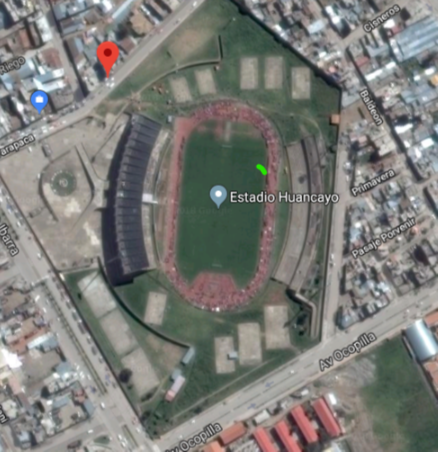

Hello. I'm from Junín-Perú. I'm helping in the work of the future Estadio Huancayo that will be built in 5 years (An Stadium).
google coordinates : -12.071819,-75.202454
URL: https://www.google.com.pe/maps/place/12%C2%B004'18.6%22S+75%C2%B012'08.8%22W/@-12.0731213,-75.201749...
