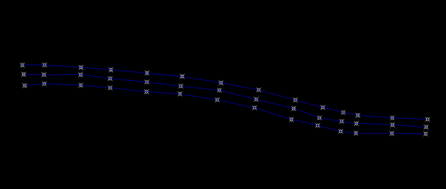

The general view of the position of the poles it this:Capturar_1_generalview.PNG
 I believe it is possible to understand the size of this demon (and it hasn't even finished - pole-wise) with this image.
It is also possible to see here that I already have much of it done. But I do not.

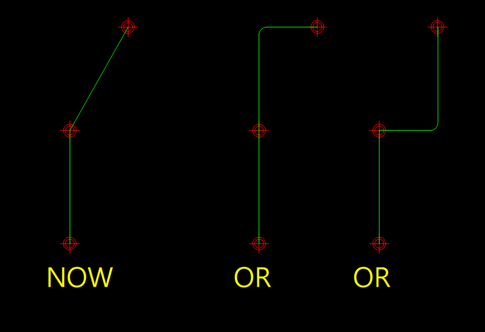

Hello, great lisp (createshortpath)
I was wondering how you coul get the line going straight on the upper line and than going down to the lower line.
Now it's going up and down.
Also I would like to insert a + on the beginning and a - at the end.
If possible even name the pline. is this possible?
regards Werner

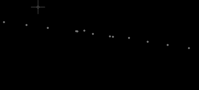

Greetings! Is it possible to change this code to create the polyline by joining the points obeying an angle criterion and not the closest path? For example, selecting a starting point and giving it a starting angle, from there the code looks for the next point to draw the line obeying the angle (range) and distance (maximum distance) criteria.
Message 18 of 43
ajmalnattika
Is it possible to make like only x-axis and y-axis only? That means only ortho mode. length of the line is no issue
Like the attached picture that
Message 19 of 43
Sea-Haven
This would be better asked as a new post its very different to the original request, the turn 90 needs some sort of rules or user input very different to the auto join.
