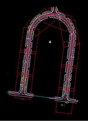

Each block can be made into an individual layout for plotting and then do sheetsets, only looking at the image it looks like you have same size for each block that makes life much easier. I have make layouts they are for more like CIVIL plans where you want layouts following roads etc. Tested making multiples at a time no real limit in terms of speed will see screen flash, it could be converted to just read blocks. Like the others importing and laying out the blocks can be done based on some rules.
What is needed is a sample dwg something like a block that is a rectang representing your blocks. So inserted multiple times representing the required layouts just need say 1 layout so can see viewport scale etc.
 Part 1 insert images like others can look at some form of front end to select blocks. May be easier to insert to many then delete unwanted, note can erase all layouts and redo the create very fast so layouts are in sequential order.
