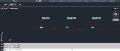

I am looking for a LISP program that will allow me to select multiple dimensions, copy them to the clipboard, and paste into Excel  in the following format (include "=")
=dimensions1+dimensions2+dimensions3+.......+dimensionsn
The command should have the following prompts:
1. Select dimensions in order by click then hit the space bar to finish the command and it auto copy the result to Clipboard
2. Then I go over to an open excel file and CTRL+V to paste the result
Results must be calculated in Excel, not on autocad
Is this possible? If not could someone suggest an alternative such that I can easily transfer these dimensions to a preexisting excel file?
