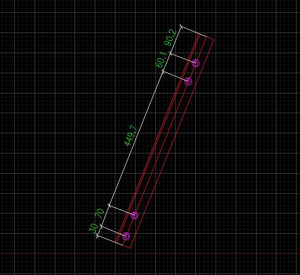

Hellos Lisp Masters I have a small situation here I have over 500 metal arms and I need to mesuare them so I was thinking on a LISP than can help me make this faster I found a few but they dont really get what I need I am new at lisp and I thinks this is for pros. Each metal arm have screws and I need to measure each screw plus the total leng of the arm can any of you help me with a lisp that can help me with that? Basically each dimension needs to stop I founf a lisp that help me a lot but it stops on each vertice of the polyline.
Thank you !!!

Here, try this code...

Sorry  but its not working for my file the dims have to be on the middle of the block and they are not its ok ill just do the 500 barres myself 😞

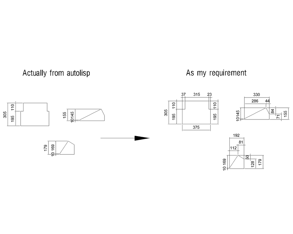

Dear all of autolisp master,
  I do not know about autolisp code, so i often seek on web to find the code related my work. And I found a autolisp app almost correct as my requirement but I have a issue with dimensions, i need only dimension lines (DLI) for object, no need Dimension Align (DAL). But It appeared at left side of object after i apply app, bottom, top and right did not apprear. Thank for your help.
The code i found from cadtips.cadalyst.com
Thank you !!!

Kent1Cooper
Illustrate, please.
Kent Cooper, AIA

marko_ribar
I've created several Layers and dimensioned each of polylines in your *.DWG... For dimensioning I used also several Layers colored with yellow... For lisp I used my recently posted autodim.lsp posted in this link : https://www.cadtutor.net/forum/files/file/54-autodimlsp/
HTH.
M.R.
