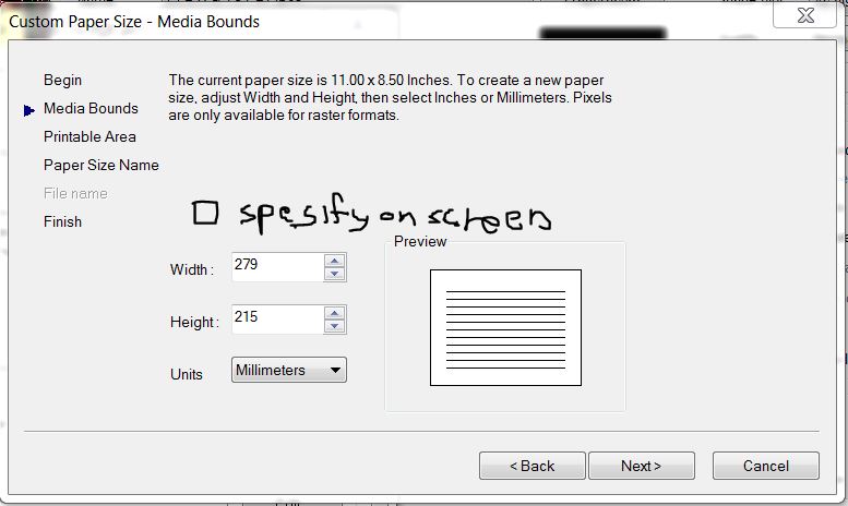

hi, thank you so much but this is not what i'm looking for
i wanna make a CUSTOM paper size (not A4) just by clicking a window on the screen - it should be simple & will save a lot of time! wonder why autodesk didn't do that yet... 😞

attached is what i want to have...
