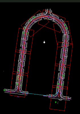

Like this, viewports are made by walking along a pline matching a title block and scale. They are rotated in the viewport to match.

Check attached Drawing with 1 layout named Sample
& Second is result using this lisp viewport.
in this lisp
problem is this lisp adding two viewports.
1st at where I mentioned in lisp.
2nd Center point of the line I draw
but I am not able to see anything in viewport not even close to Line.
