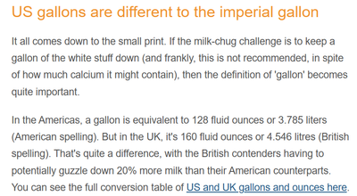

Another way to display the answer. NOTE 231.0 not 231 to make sure get a real answer not an integer answer.
(alert
(strcat
"\n<!> 3D Volume = \n"
(rtos (vla-get-volume 3dObj) 2 2) " cubic inches, or \n"
(rtos (/ (vla-get-volume 3dObj) 231.0) 2 2) " gallons, or \n"
(rtos (/ (vla-get-volume 3dObj) 61.02374) 2 2) " liters. <!>"
Just a side note
