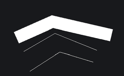

Sea-Haven
This worked for me I drew plines with a width of 0.025 ie 25mm pipe it drew a single skinny line, looked like a single line in the pdf. The advantage is get length and width * 1000 etc. Maybe its my Bricscad. Did not test very much.
Fat line is 5 others are 0.025 & 0.016
