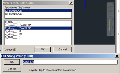

For testing - XDTOOLS_VEDIT.lsp.
View, enter, edit contents of XData:
For all selected objects.
Note: The programmer is a beginner, an amateur, so the code may be very weak.
But the program (it seems) does everything I think is necessary.

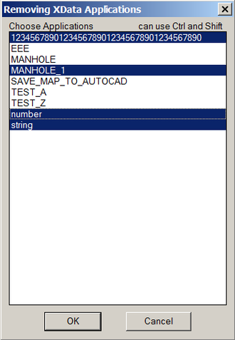

New command - to remove the specified XData from selected objects, XDTOOLS_REMOVE based on CADaSchtroumpf routine.
Any number of XData applications can be specified.
The attached archive with the other 6 commands is XDTOOLS-v-0-5.zip.
