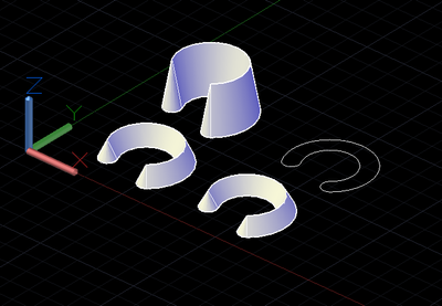

I don't know why it didn't occur to me to just use the outline of the base directly, with the tip of the yellow triangle on it, this way:
But for some reason, it says it can't Extrude that triangle in this situation.  It's not that it doesn't touch the path -- INTersection Osnap says they touch.  I tried it in both the WCS and the triangle's UCS.  It's all accurately drawn with good Snap values.  I couldn't say why the previous approach works but this doesn't, but as long as something does....

leeminardi
Here's another way to construct the solid given a closed 2D polyline.  Use the Extrude command with the Taper option.  It avoids the need to create the triangular cross section.
The following code will create the shape with a taper angle of 25°.
THE TOP VIEW MUST BE ACTIVE WHEN THE COMMAND IS GIVEN!
