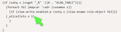

Message 25 of 30
This is my current code and it isnt working. I have a unlock table code running at the startup as well as this. Did I just type the (_foo 1) in wrong or is this a bigger issue?
Thanks!!

Message 26 of 30
ronjonp
What command are you calling? ( FT FR FTFR ?) If you want my code to run it has to be called within the function you're running.
Message 27 of 30
This is the error message i get--
error: no function definition: _FOO
Message 28 of 30
Those commands are there for changing the text and row height of my tables because my tables dont like autocad 2021
Long story short, my company's template is really buggy with autocad 2021 so im trying to find a function to fix it all upon startup so we can all move to 2021
Message 29 of 30
ronjonp
Then you have not loaded the function? Need to run an errand back in a bit.
Message 30 of 30
pbejse
@ronjonp wrote:
You need to post your drawing .. can't troubleshoot a screen capture.
😆 Very true.
Legend has it, there is one forum member still staring intently at the snapshot ...
