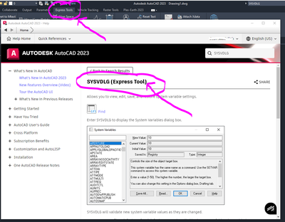

pendean
Community Legend
Community Legend
@sby0531 wrote:
...I didn't find SYSDLG command in AutoCAD  2023. Is anything wrong?...
...Unfortunately, the version of AutoCAD that I am using is 2015....
It appears you don't know about a few important things, but here is one easy fix, you forgot to install Express Tools in your AutoCAD version (whichever it is)
OR... YOU DON'T KNOW THAT YOU ARE ACTUALLY USING AUTOCADLT VERSION IN WHICH CASE SYSVDLG COMMAND IS NEVER GOING TO BE AN OPTION.
