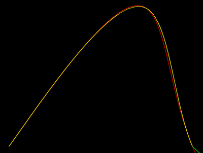

Why not?  It's very easy with a Break command, and the coinciding part may not be possible in drawing two new ones.  You certainly can't just use the break point as the end of one and start of another -- here the red is the original, and the yellow and green are what happens when you do that:
[Even for a Polyline, that approach becomes challenging if the break point falls on an arc segment.]
Even if one could figure out how to calculate the end tangent directions for use in something like (entmake), that doesn't make it coincide.  Here I manually adjusted them for the yellow one as close as I could visually at the ends:
and the shape doesn't coincide in the vicinity of the middle fit point:

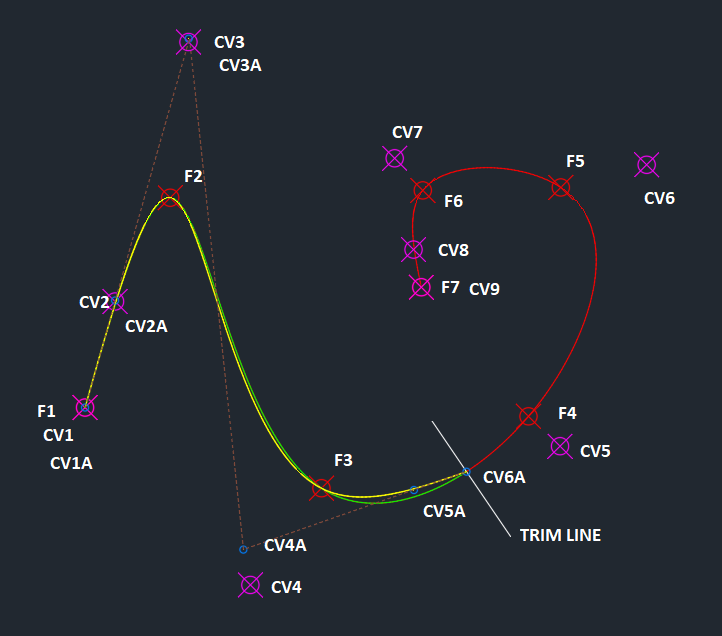

leeminardi
If you construct a spline in AutoCAD and do not modify the weight values from 1 for all control vertices then the result will be a B-spline (a special case of the more general NURBS).  You can construct a spline in AutoCAD using Fit points or CVs.  If you use the Fit Point method then the CVs are automatically determined.   In the image below a degree 3 B-spline was constructed using fit points F1 thru F7.  The CVs CV1 thru CV9 were determined by AutoCAD's spline software using math beyond this discussion. The  red spline was trimmed at the the trim line using the trim command resulting in the green curve (the green curve exactly overlaps the first part of the red curve.   The CVs for the trimmed spline (green) are CV1A thru CV5A.
The yellow curve was constructed by using the original fit points F1 thru F3 plus the trim point (the end of the trimmed spline).  Note that it is not the same shape as the original curve and thus using the original fit points are of little, if any, benefit.
You could construct a spline using Fit points as discussed here but would need to know the tangent vectors for the ends.  I generally consider that once a spline is edited its fit points become irrelevant.
I am aware that you want to avoid using "command" in your code but  I think a more practical approach would be to use the commands break or trim to break a spline into two pieces than trying to add the math to calculate the necessary data needed to build the two splines.
