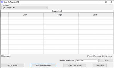

Could you please help me again Sir ?  I have already set-up as per your tutorial  . Then when I pick create table --> click to the "Select and get objects" then choose some lines but it said  "0 found"
Message 26 of 28
baksconstructor
Before this, you need to tell the program that this is your desired object.
You need to select all your segments or polylines or other objects.
Then open the properties window.
In the properties window, in the parameters, specify the name.
For example, for all objects at once, you can write the name "Lines" or "This is mine"
Then the object will be marked that it needs to be processed.
The main function of the program is to give any properties to any object. And if there are properties, then this is the desired object and you can get additional data from it.
After this, you can get a table for these objects.
Message 27 of 28
caominhnguyen85
FINALLY, I DID IT JUST AS I WANTED. THANK YOU AGAIN FOR YOUR DEDICATED GUIDANCE. I DIDN'T EXPECT THIS TO BE SO USEFUL. HOPEFULLY, IT'S FREE.
