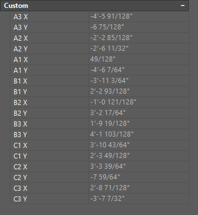

I'm trying to return a list of parameters (specifically point parameters, and their locations) when I select a block. and while I understand vla-vlax- functions are faster, I am trying to accomplish this in AutoLISP without them.
Can anyone describe or provide some code as to how I can accomplish this? I'm not an expert at managing DXF codes or searching dictionaries/Xrecords/tabels yet, but I do feel pretty competent if pointed in the right direction.

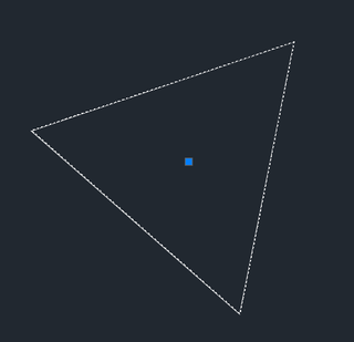

Example:
I have a block with a triangle. And within that block are point parameters with X / Y locations...
...I would like to CHECK if this block has point parameters THEN get their locations if so. All without help of vla-vlax- functions.
Attached is a sample dwg.
...partial code:

(dumpallproperties blkEnt) shows you how to do:
Command: (getpropertyvalue blkEnt "AcDbDynBlockPropertyA1 X")
0.380249
Command: (getpropertyvalue blkEnt "AcDbDynBlockPropertyA1 Y")
-54.1079
Command: (getpropertyvalue blkEnt "AcDbDynBlockPropertyA2 X")
-26.6635
More generally, to get (or set) a dynamic block property: (strcat "AcDbDynBlockProperty" propertyName).

CodeDing
@_gile,
Thank you for the reply! I am actually familiar with the "getpropertyvalue" function, and I am sorry because I was not more specific in my original post.
TO BE MORE SPECIFIC:
I am trying to return the point parameter values if I do NOT know their names.
I would like to search a block for point parameters, THEN return their names/values so that I can manipulate them even if they are different per block.
My apologies for not being more specific.

_gile
Sorry, I read to fast you question.
Here's a way:
(setq blkName (getpropertyvalue blkEnt "BlockTableRecord/Name"))
(setq block (entget (tblobjname "block" blkName)))
(setq blockRecord (entget (cdr (assoc 330 block))))
(setq xDictionary (entget (cdr (assoc 360 (member '(102 . "{ACAD_XDICTIONARY") blockRecord)))))
(setq enhancedBlock (entget (cdr (assoc 360 (member '(3 . "ACAD_ENHANCEDBLOCK") xDictionary)))))

The last expressionallows to dump the dynamic parameters
With the block you provided, it returns the following list. Code 303 is what you're looking for with Point parameters but it may differ with other types of parameters (linear, visibility,...)
