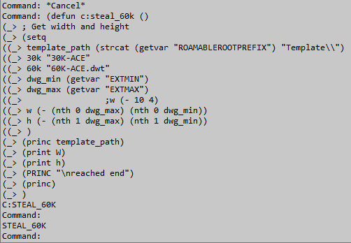

I started to work on a script that I plan on using Lee Mac's Steal command to import layers into older drawings:
(defun c:steal_60k ()
	; Get width and height
	(setq
		template_path (strcat (getvar "ROAMABLEROOTPREFIX") "Template\\")
		30k "30K-ACE"
		60k "60K-ACE.dwt"
		dwg_min (getvar "EXTMIN")
		dwg_max (getvar "EXTMAX")
w (- 10 4) ;w (- (nth 0 dwg_max) (nth 0 dwg_min)) ;h (- (nth 1 dwg_max) (nth 1 dwg_min)) ) (princ template_path) (PRINC "\nreached end") (princ) )
 When I either delete the "w (- 10 4)" line, or change the hyphen to a plus, the script works fine.

dbhunia
After running this....
	(setq
		30k "30K-ACE"
		60k "60K-ACE.dwt"
                ;w (- 10 4)
	(print W)
	(print h)
	(princ)
I did not get anything wrong....
My output is......(what is your output )

This is what I got when I copy/pasted what you did.
But if I change the subtraction to addition:

CodeDing
@Anonymous,
Try declaring your variables as local, so they reset  each time. See if that helps any...
(defun c:steal_60k ( / template_path 30k 60k dwg_min dwg_max w h)
Best,
~DD
Message 8 of 8
I will try that. Restarting AutoCAD luckily fixed the error, but I will add them as local too. (I'm still learning LISP. I'd rather use VBA, but I was told LISP is more powerful within AutoCAD, and my IT department won't install the VBA IDE for me).
