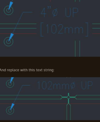

Is there a find/replace lisp routine will allow you to FIND multiple lines of "hard returned" text within a leader...and REPLACE multiple lines of "hard returned" texts?

Kent1Cooper
@anderson51 wrote:
I am unable to get it to work....
Can you post a drawing file with a few matching Mtexts, and indicate on which one you first picked as the source?

Start an MTEXT command, and type in "this is" [Enter] "a test" {finish the command by whichever means you choose}.  Select the result [middle below on the black background] and see what its Contents are [Properties palette excerpt at left].  They include the \P representing the hard return causing the move to a second line of text.
As I understand it, they want something equivalent to the right part [part of a FIND dialog box] -- namely, to put "this is a test" into something, and have it find that Mtext object, despite [or "around"] the hard return within it.  FIND does not find it, even if, in the  Find what:  entry, you include the \P [as displayed in Properties] or the \\P [as listed in entity data].  That is the reason why FIND is not suitable for their intended purpose.
It's equally unsuitable [i.e. equally unable to find that Mtext object] if you use the Shift+Enter way of getting a new line.  And that has a weird twist:  in the Properties palette Contents slot, all that shows is the part before the new-line, i.e. only "this is", until you pick in it, then it shows "this isa test" without showing the \n that's in there, though it appears in the entity data content entry.
Kent Cooper, AIA

After some playing around, about the best I can do short of jello, is to
underline (with line entities) where the searched string might be found.
John F. Uhden

The find part isn't that hard, but the replacement could be.  For example, suppose we had the following mtext with hard (or soft) returns at the end of each displayed line...
"The quick brown
fox jumped over
the lazy dog."
and we want to replace "brown fox" with "northern grey squirrel."
I can remove all the returns to get a continuous string, but where do I put back the first return, after "northern" or after "grey" or after "squirrel?"  I'm certainly not going to attempt to distinguish adjectives from nouns.
Now if every case were to be the removal of just the entire first line, then it's easy, but it wouldn't be very popular.  Hmm... one way might be to shrink it's width to let AutoCAD apply a wrap if the added string is too long, but that's just a guess as to the desired result.
So, would it be helpful enough to just mark the finds with an ellipse or closed polyline box and leave the replacing to the user?
John F. Uhden
