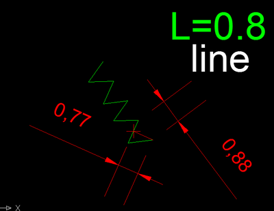

... But the principle of dependence on zoom etc it is impossible to avoid?
Still there are markers, disputable for me, - on the ends of "polyline" from many pieces:
Using a graphical selection mode, we'll have to objects visible in the drawing, so,
'But the principle of dependence on zoom etc it is impossible to avoid?'
Using ssget with a graphical selection mode, it will always be zoom dependent...
In the above image, the objects are lines, the code will test for other object within the 'Minimum Gap' and if finds one entmake a circle...
Henrique
I - not to the programmer - for the general reasons not clearly, why to the program need zoom, etc? After all the program processes data without participation of the person, i.e. without need to see on the screen.
Use of zoom, etc leads not only to work delay. Probably, it complicates also the analysis of data - if at the same time there are both very big and very small elements if there are very fine details of elements, etc.?
Possibly, such approach can lead to processing errors? To impossibility in some cases to receive exact and full result? (For example how it happens to BOUNDARY?).

@АлексЮстасу wrote:
But still there was a question about "polyline" from pieces.
If it was really the polyline, gap wouldn't be.
 Alexander,
there will always be cases, with one of the test I did use at the 'demo', that will generate false positives, I did use 'vlax-curve-getClosestPointTo' function to calculate the point on the near object, and get the distance to calculate the gap...
Using a Maximum Gap of 0.80, the 'vlax-curve-getClosestPointTo'  function will return a point on the near object at a distance of 0.77, a false positive...
The revised code:

Message 30 of 55
Henrique,
         I finnaly got to play around with the code, and it works great. I understand now why its creating gap circles where I wasnt expecting them.
Like this example will produce a gap circle, because of the distance from the green corner to the peach line. However since the Peach line does fall on the green line I would like this to not get marked. If this is possible great, if this is far as we can go, I'll mark your lisp as a solution. It works good enough that I can use it for my purposes. Thanks for all your help.
-Chris
Message 31 of 55

You're welcome, Chris!
I did made some untested modifications to the 'demo' (I'm a very big workload), probably the previous situation It is already corrected.
