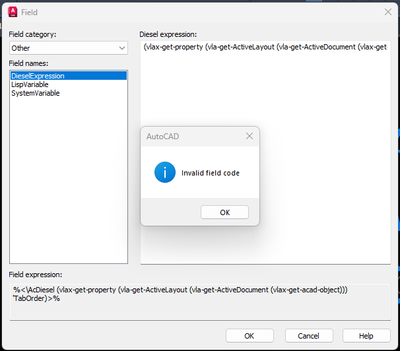

mohandis2
invalid field code

@mohandis2 wrote:
invalid field code
I suspect that LISP code does not run in FIEILD's pop-up
