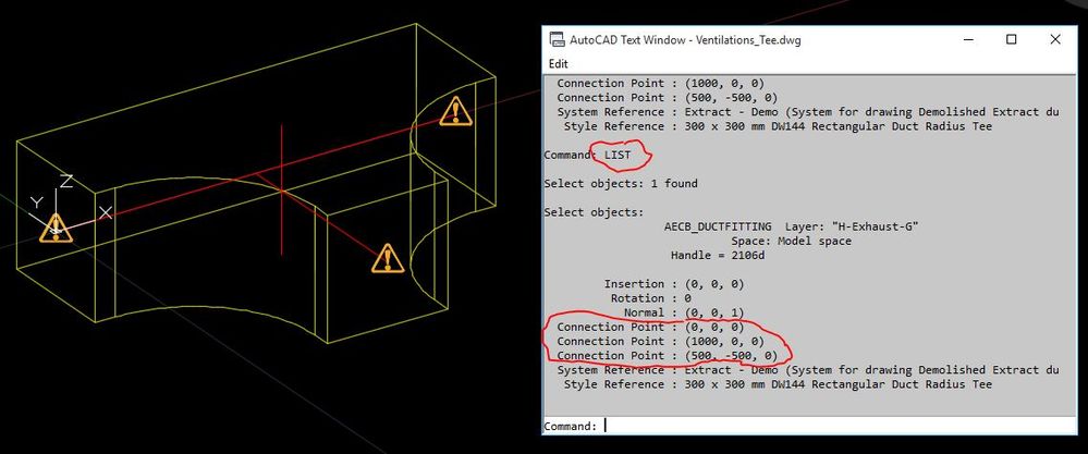

Hi
Does anyone know how to extract via lisp the connection points coordinates of AutoCad Mep objects?
I don't mean simple duct or pipe -becouse start and end point of those objects I can get by "vlax-dump-object" - but tees, elbows and other fittings and equipment objects.
List (autocad command) can display that information in textscreen but from there the coordinates can only be copied manually.
I want to assign those coordinates to a variable
Thanks for any help

Below - screenshot showing that I ment.

Thanks to devitg, who suggested me using logfile to read what "list" (autocad dommand) returns I managed to write a lisp that retrieves connection points of pipefittings, ductfittings and cabeltrayfittings. Also if I wanted to retrieve just one connection point of the picked end of the fitting, there is a simplier method - before entsel AECBOSMODE system variable has to be temporarily set only to connectors, and OSMODE to 0. Then (cadr (entsel)) returns coordinates of that connection point.

The endpoint data is what i'm looking for. I intend use that data to identify shared points for a total count of clamps that we will need for this type of pipe.
Command: HAVEADUMP
Select object:
; IMapsComWrap: IMapsComWrap Interface
; Property values:
; Application (RO) = #<VLA-OBJECT IAcadApplication 00007ff619731e30>
; Area = 0.621774
; CustomData = "Manufacturer = ,Model = ,Model Option 1 = ,Model Option 2 = ,Model Option 3 = ,Model Option 4 = ,Device Handing = ,Device Tag = ,Device ID = ,CFM / GPM = ,TYP. X = ,Room No = ,Weld Inches = ,Fabrication Time = ,Asset ID = ,"
; Description = "Blucher Pipe - SS-316 [ 2\" ]"
; Document (RO) = #<VLA-OBJECT IAcadDocument 0000019fa7175bb8>
; Elevation = "BOP/I: 13'-10 3/16\""
; EndSize = "Straight 2, Socket 2, "
; EntityTransparency = "ByLayer"
; Handle (RO) = "246E1"
; HasExtensionDictionary (RO) = 0
; Hyperlinks (RO) = #<VLA-OBJECT IAcadHyperlinks 0000019fa1697868>
; ItemNumber = "3380"
; ItemServiceType = "Pipework"
; ItemSpoolName = ""
; Layer = "P-WV_N_PIPE_W"
; LengthAngle = 100.506
; Linetype = "ByLayer"
; LinetypeScale = 1.0
; Lineweight = -1
; Material = "ByLayer"
; Notes = ""
; ObjectID (RO) = 44
; ObjectName (RO) = "MapsContainer"
; OwnerID (RO) = 43
; PlotStyleName = "ByLayer"
; Points = "ENDPOINTS: 1260.76,802.77,167.39;1361.24,802.77,169.48;"
; Section = "None"
; ServiceName = "W (AG - Blucher SS-316)"
; Status = " 0: Design"
; TrueColor = #<VLA-OBJECT IAcadAcCmColor 0000019fa16975c0>
; Visible = -1
; Weight = 0.0
; Methods supported:
; ArrayPolar (3)
; ArrayRectangular (6)
; Copy ()
; Delete ()
; GetBoundingBox (2)
; GetExtensionDictionary ()
; GetXData (3)
; Highlight (1)
; IntersectWith (2)
; Mirror (2)
; Mirror3D (3)
; Move (2)
; Rotate (2)
; Rotate3D (3)
; ScaleEntity (2)
Message 11 of 12
andkal
The list you provided says "; ObjectName (RO) = "MapsContainer"".
Lisp routine I posted works with fittings made in Autocad MEP (object type: aecb_ductfitting). It wont work for your object. I assume your object was created in some third party plugin installed on Autocad MEP.
Try to display what is under group code 10. for this entity (use f.e.  http://autolisps.blogspot.com/p/disprop.html)
10. is a primary point, but not all object types have that property. Primary point may also not necessarily be an end point which you are looking for.
Im not sure if autolisp will help you.
• www.autolisps.blogspot.com - Productivity plugins for Autocad and Autocad MEP
• Autodesk AppStore
Message 12 of 12
CWagnerLYWJP
I assume there is a way to use the data using that script but for everything that I have selected and some how parse the Endpoint data into a list, eliminate shared points, and then use the list length to give me the point count right?
My issue atm is Im trying to learn these things inbetween tasks haha.
