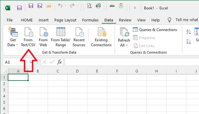

ВeekeeCZ
Import it the other way around.
Run Excel, use Data / Import Txt/Csv ... then save it as *.xls.

ВeekeeCZ
It really has nothing to do with programming experience. It's Excel.

Sea-Haven
This forum is English based so post both, use Google Translate.
"I'm sorry even more I'm learning to program, could you explain it to me more detailed."
Also Double click in explorer csv file Excel will open file Automatically, or Start Excel File choose csv file
Google translate
Também clique duas vezes no arquivo do explorador csv O Excel abrirá o arquivo automaticamente ou o Arquivo Iniciar Excel escolherá o arquivo csv

Message 13 of 13
edsaqueteAG5Q7
It's working, thank you
