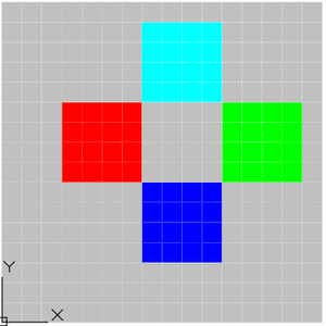

I have been trying to figure out how to do images in DCL/LISP for awhile and can't get anything to work. Can anyone figure this out for me? My sample.dwg, lsp and dcl files are attached. What I really want is to replace the current dropdown boxes with two columns of images (as shown in CAD). Each row would be a button. It could be an image, then a radio button and text if required. But, I think you can make the images buttons, thus getting rid of radio buttons?
This would be amazingly helpful since the drafter currently picks the holdown by reading a description of the image (ie, triangle / solid triangle, circle / triangle). That's clunky and not efficient.
 Any help would be appreciated?

hak_vz
@nathanwheeler27
There is another method to create icons that can be used with DCL buttons and other GUI elements.
It uses vector_image and fill_image method.
Tomorrow I'll post a set of autolisp scripts to create (draw) bitmaps like representation i.e. ACI color list representation of a  bitmap image on the DCL image tile or image_button tile  with the given key.
With it you will be able to create standard size  16×16, 32×32 or larger icons. Creation of icon
mimics the one that is used in icon generator applications, but inside Autocad environment.
It is not a converter, but it may be used. Created icons are not art masterpiece but that can be of some use.
This method requires user to spend some time to create icons (max 5 mins) and how to use DCL. Bitmap representation is stored inside lisp file as a list stored inside variable (for better performance) or just temporary.
Icon will look like the on in attachment, but shown in pixels. Background gray color is replaced with the color of
gui element., ie. button or image_tile. In attachment is a sample 16×16 icon.
Miljenko Hatlak

hak_vz
@nathanwheeler27
Here is my follow up to @Lee_Mac solution to fill DCL image_tile or image button.
There are three functions BMPINIT, BMPDRAW and BMPGENERATE.
First one creates raster of hatch elements where each hatch rectangle mimics a pixel. You can use any size you want, resulting icons (image tiles ) are of rectangular shape.
Use command BMP draw to change color of individual "pixel" and draw your icon.
To change color just change current system color.
Command BMPGENERATE creates text file and renders the supplied ACI color list representation of a
Generated code  looks like this:
(setq back_img
           001 005 192 192 192 192 192 005
           001 005 192 192 004 004 192 005
           001 005 192 004 004 004 192 005
           001 005 004 004 004 004 192 005
: image
key = "back_img";
width = 1.33;
aspect_ratio = 1.0;
fixed_width = true;
fixed_height = true;
color = -15;
First section is a definition of a variable that holds image definition. Second part is one that goes into DCL file.
Change image to image_button if needed. This would be a definition of an 8×8 px icon that looks like this
Included is @Lee_Mac 's function DisplayBitmap that you include inside your lisp file.
To populate DCL image tile after you load  DCL you just have to do this:
(new_dialog "band_beams" dcl_id_band_beams)
(DisplayBitmap "back_img" back_img)
(action_tile "back_img" "(back)")
(start_dialog)
Always work inside a new dwg file.  Work seequence is BMPINIT, BMPDRAW, BMPGENERATE.

hak_vz
@nathanwheeler27Here is a lisp file with auto generated DCL for my method.
I am using this exact same method but my images are coming out flipped on the Y axis. Any idea how I could fix this? If I reverse the list it just flips it on the X axis.
This is supposed to be a "P"
Message 15 of 16
hak_vz
@J_Spurgeon
I didn't mentioned before, but you have to mirror your image definition over y axis. That is the way it works in Autocad.
In my code above I have created arrow pointing to the left (code) to create right side arrow.
(setq back_img

Message 16 of 16
J_Spurgeon
@hak_vz wrote:
@J_Spurgeon
(setq back_img
Ahh dang, that is going to be tough, I have 48x48 images lol
