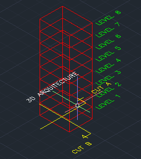

is there any way to create Xclip since model views of external drawings, and insert the created xclip's as one selected script?
I mean, create xclip of model view 1 and insert it in the coordinates 0,0,0, xclip 2 should be 0,1000,0 ,etc...

I attached a representation.
if  I have a 3d model and Model views like this:
then I should show a layout representation like this:

basically I description how AutoCAD MEP create layouts, create model view and insert it in layouts, the unique difference is that I need to cut that xref with xclip in same area that the layout, and as there are multiple layouts then I need put that xref xclip-ed in the model space in order.
