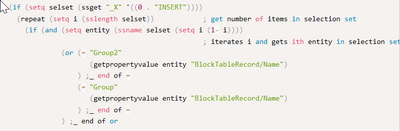

Egbay
It is working after a couple a test runs. When coworker gets back form vacation Ill see if he is still having issues.
Just to make sure I am understanding the code, in the code section attached, whoever is using this lisp would need to update depending on how many "Group" blocks there are right? So if this had a group3 and group4 it would need to be added in.
I dont anticipate a large number of variations but just want to have the understanding. To me it seems like the top part would count how many "Groups" there are and iterate through. I could just be understanding it incorrectly though. I haven't done much lisp programming but know some C and C++ through school.
