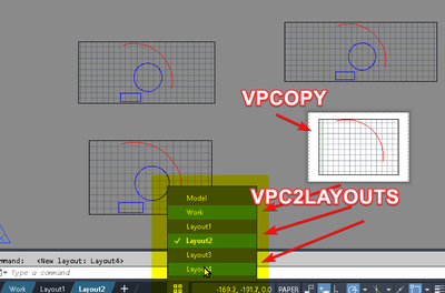

Anyone know if there exist any lisp to Copy ViewPort's layer settings to Selected Layout's Viewports?
S78QeG
Something like this:
1 Activate the first Layout to change
2 double click to ViewPort
2 Thaw/ Freeze your layers (viewport)
3 Run AutoLisp routine
4 Copy the configuration to all selected Layouts

Thanks lot, this work for select multiple Viewport at same Layout.
excuse me, could add an option more for select multiple Layouts? I mean, some like:
1 Select multiple Layouts (PaperSpaces)
1 Run c:VPCopy
2 Select the Viewport to Copy
3 Run new command c:VPC2LAYOUTS, to copy the stored list to all ViewPorts in the selected Layouts (PaperSpaces)

Any way thanks a lot, but maybe I used this routine wrong?
Could explain us a bit how use VPPASTE to multiple Layouts_Tabs? or if this is not possible?

(defun c:VPVAll (/ tempstr int smallstr vpent laylist e tabs oldtab oldecho vpss idx) ;ViewPort (V)paste

jtm2020hyo
thanks for you last routine, this complete my work.
