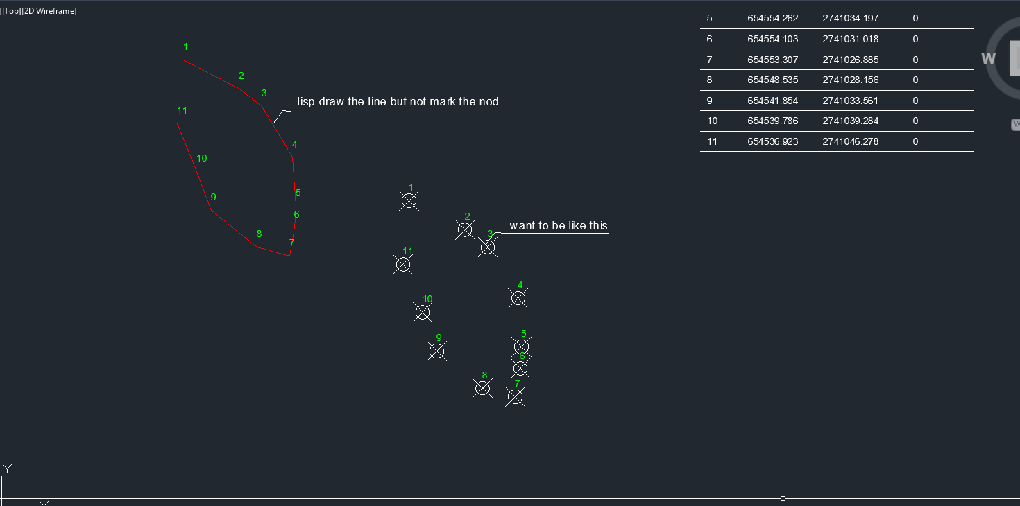

coordinates lisp draw the line instied of point please guide,,, regards

@iftikhargulmrd ,
1) What is your question? Please explain.
2) Can you post an image of your work area BEFORE you run the command and AFTER you run it so we can see also?
3) Copy & Paste your command history after you run the command. Often times this will provide valuable feedback as to what is going wrong.
Best,
~DD
Message 3 of 11
iftikhargulmrd
instead to draw the line to mark nod
Message 4 of 11
Sea-Haven
A quick fix not tested
change
bs3 (COO bs ha (+ ds2 (* 20 H) ds3))
to
(command "point" b)
change (command "pline" B "w" "0.0" "0.0" c "") to (command "Point" c)

dbhunia
Change as below...

(command "layer" "n" "table" "c" "7" "table"
"n" "line" "c" "1" "line"
"n" "no" "c" "3" "no" ""
(command "layer" "s" "line" "");;; set the Layer as current.
(command "Point" b)

NO (+ NO 1)
c (getpoint "\nEnter next point:")
;(command "pline" B "w" "0.0" "0.0" c "")
(command "Point" c);;; @Sea-Haven also said this.
(setq b c)

Message 6 of 11
iftikhargulmrd
appreciate booth of you brothers,
but one issue first number is not mark the nod
Regards
Message 7 of 11
dbhunia
But it is working for me.....
Watch this....
