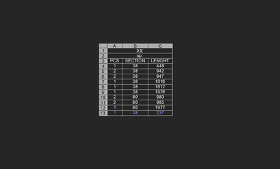

Hello everyone,
I have this lisp code and I need only one change: the order of the values ​​under "LENGHT" should be sorted in descending order, and should have priority over the other values ​​and colors.
I only need this step, but I'm having trouble. Can you help me please?

paullimapa
change the following section of the code from:
          (vl-sort
            (vl-sort
              (vl-sort
                (mapcar '(lambda (a) (list (fix (cadr a)) (fix (caddr a)) (fix (cadddr a)) (car a))) r)
                '(lambda (a b) (< (caddr a) (caddr b)))
              '(lambda (a b) (< (cadr a) (cadr b)))
            '(lambda (a b) (< (car a) (car b)))
To this:
(vl-sort
            (vl-sort
              (vl-sort
            '(lambda (a b) (> (caddr a) (caddr b)))
