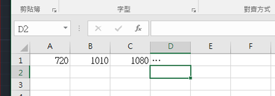

As captioned top, I want to copy the dimension to excel from left to right cell. How can I do? Anyone help?

paullimapa
Give dimtoxcl.lsp a try.
This should take all the dimensions you select in the same row and sorts them left to right and place in to row in Excel.

vladimir_michl
You can try the freeware utility Click2XLS (its Text2XLS command) - supports all kinds of drawing texts, incl. dimensions as they are displayed.
https://www.cadforum.cz/en/export-text-from-dwg-drawings-to-excel-tip9814

skchui6159
EXACTLY WHAT i WANT! THANK YOU VERY MUCH!

skchui6159
If I need to sort x=right to left?
I find it. It should be
(defun sortListofSublistsbyItemX (lstOfSublists intItem)
(vl-sort lstOfSublists '(lambda (X Y) (< (nth intItem X) (nth intItem Y))))
) ; sortListofSublistsbyItemX
">" change to "<"

paullimapa
yep, that's it!!!
