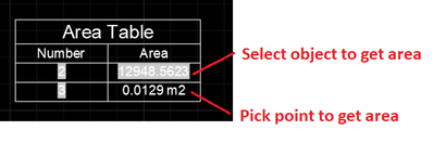

How? i am okay with the unit to appear or not but my consern is more on the area number. In my cad, its appear 1234567 and not 1.23. I want it to be 1.23 m2.
Message 4 of 10
paullimapa
Looks like the problem is when you select the object it does not honor the suffix value or the conversion factor when using the AT command:
You may want to contact Lee Mac to see if he can update this code.

the PICK mode creates a stupid Text, the OBJECT mode creates a (linked) Field.
So if possible, the object mode is prefered.
For pickmode, it uses the cf option and your current luprec (and dimzin) setting
For objectmode, it uses the fo (format) option!
Check out what the right fieldcode is, for your needs, and change the fo value.

in addtion to @cadffm if you want to also include suffix m2:
fo "%lu6%qf1%ps[, m2]%ct8[1.000000000000000E-006]"    ;; Area field formatting

asyraf_msuhaimi
Thanks bro! its worked now.
Message 9 of 10
asyraf_msuhaimi
Thank you! all good now. I just need to figure out how to round off the number to 2 decimal place.
Message 10 of 10
paullimapa
"I just need to figure out how to round off the number to 2 decimal place. "
Just follow @cadffm example.
Double click on the Field to see what the Field expression window at the bottom shows now...
specifically the section in between \f and >%
Then under Format: select Decimal
And under Precision: change Current precision to two decimal places ie: 0.00
Now copy the section in between \f and >%:
"%lu2%pr2%ps[, m2]%ct8[1.000000000000000E-006]"
Finally paste this next to fo as the area format:
...cheers!!!
