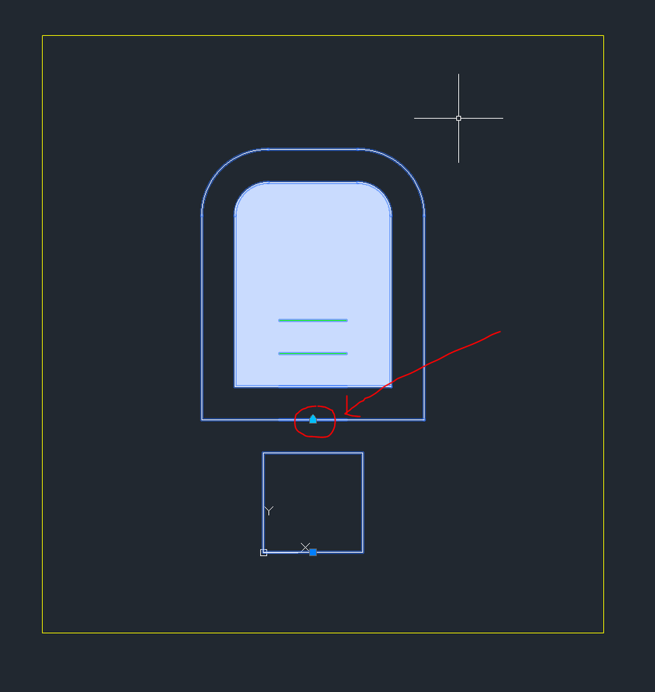

adaptacad
@Kent1Cooper  Thank you very much!! it Works very well!
How do I rotate at the same angle as "Block_Mult"?
How not to insert in the base of "Block_Mult" but in the place of the example?
Message 8 of 22

adaptacad
@hak_vz It Works very well. Thank you!!!

Message 15 of 22
Kent1Cooper
@adaptacad wrote:
@Kent1Cooper This point with the same rotation as the block.
Is "this point" not  the insertion point of that Block?  The blue square down lower looks like a grip, which presumably would be the insertion point.  If that's true, I suggest you redefine the Block to make the point you want at a specific location its insertion point.  Otherwise, the routine will need to do some calculation, affected by the rotation, of the insertion point to use in order to land "this point" at the insertion point of the closest-to-view-center Block.  And you will need to build the distance from this Block's insertion point to "this point" into that calculation.
Kent Cooper, AIA

adaptacad
@hak_vz  It's working very well, I would just like to move the block to that point.
understand?
Message 17 of 22
adaptacad
@Kent1Cooper  I can't change the base of the block! 😕
Message 18 of 22
Kent1Cooper
If the recently-posted images show the Block at zero rotation, and if you want the location at the freehand arrowhead point to be what's at the insertion point of the closest-to-view-center Block, try this variant [untested]:

hak_vz
Will write it later.

Message 20 of 22
hak_vz

            (command "rotate" (entlast) "" mp (rad_to_deg(cdr (assoc 50 (entget e)))))
            (command "move" (entlast) "" mp (polar mp (+ (cdr (assoc 50 (entget e))) (* 0.5 pi)) 2.5))
